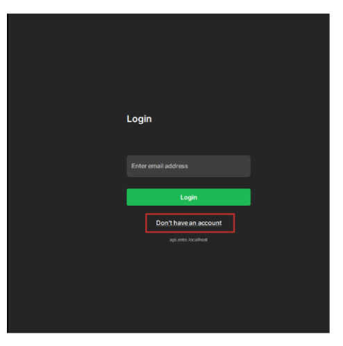

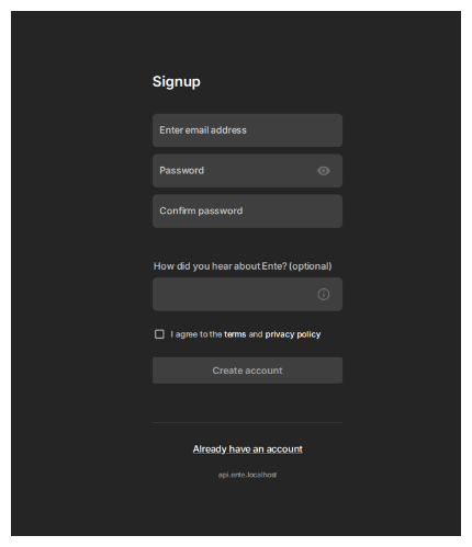

Once Ente is up and running, the Ente Photos web app will be accessible on http://localhost:3000.
Select Don't have an account? to create a new user. Follow the prompts to sign up.

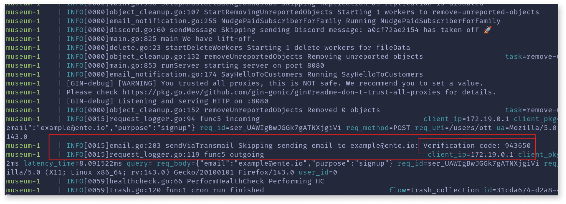

Enter the verification code to complete registration.
This code can be found in the server logs, which should be shown in your terminal where you started the Docker Compose cluster.
If not, access the server logs inside the folder where Compose file resides.
sudo docker compose logsIf running Museum without Docker, the code should be visible in the terminal (stdout).

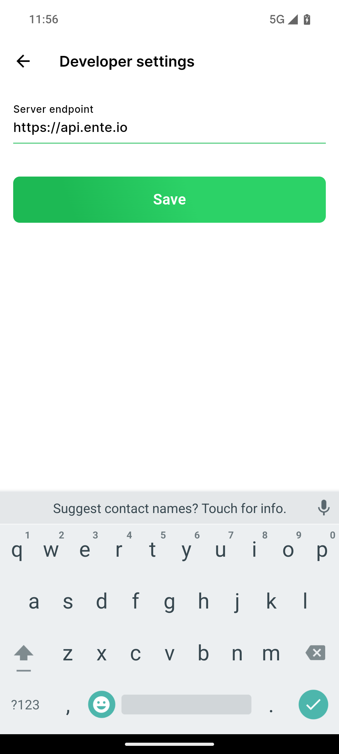

Step 6: Configure apps to use your server
You can modify Ente mobile apps and CLI to connect to your server.

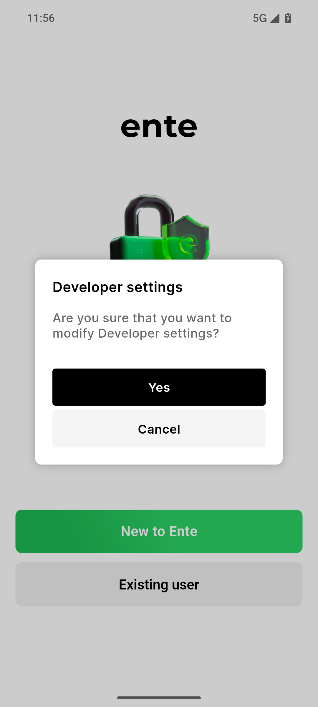

Mobile
Tap the onboarding screen 7 times to modify developer settings. Enter your Ente server's endpoint.
